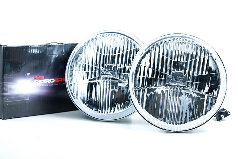

If you want headlights with the latest LED lighting technology for your Mini but you don't want some goofy modern headlights that look like robot's eyes, you now have a new option.
Holley has developed a round 7" LED headlight that looks like old-fashioned (aka period-correct) headlights.  It's the best of both worlds.  They are not cheap at $400 a pair, but the LED lighting technology should be a vast improvement over halogen lights.
https://www.headlightrevolution.com/Sealed-Beam-Holley-RetroBright-LED-Headlights-7-Round

So $250 in.  While my setup works well, the completely engineered from scratch LED solution from Holley might be worth the extra money.
