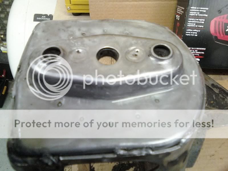

Did some scraping and some wire brushing today just for a short time between shirt jobs. Man, now it's hard to do my work with the subbys at the shop looking at me! Here is just one tower cleaned up, with some Ospho on it. I actually think I might be able to get the front subby in my pop's blast cabinet. It's worth a shot.
