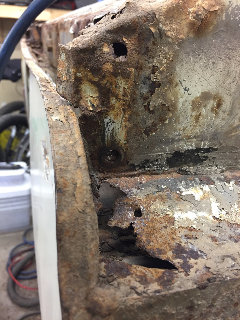

I knew the right front rear subframe mounting area was more hole than metal:
[smg id=2140]
And I found out early on in the process that the right scuttle closing panel was mostly missing:
[smg id=2138]
But I thought that the right scuttle was in better shape than it is:
[smg id=2139]
Not sure what happened there, but I suspect it was a combination of dirt piled up on top of the ventilation hose and the radio antenna installed in the right side A-pillar.

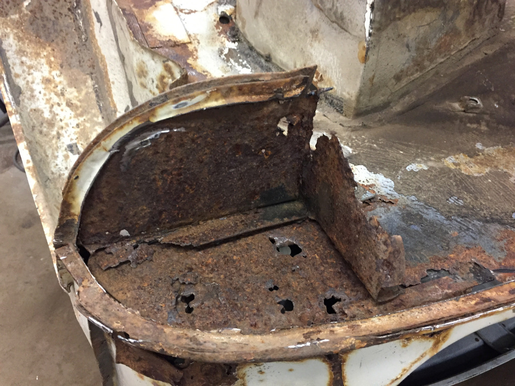

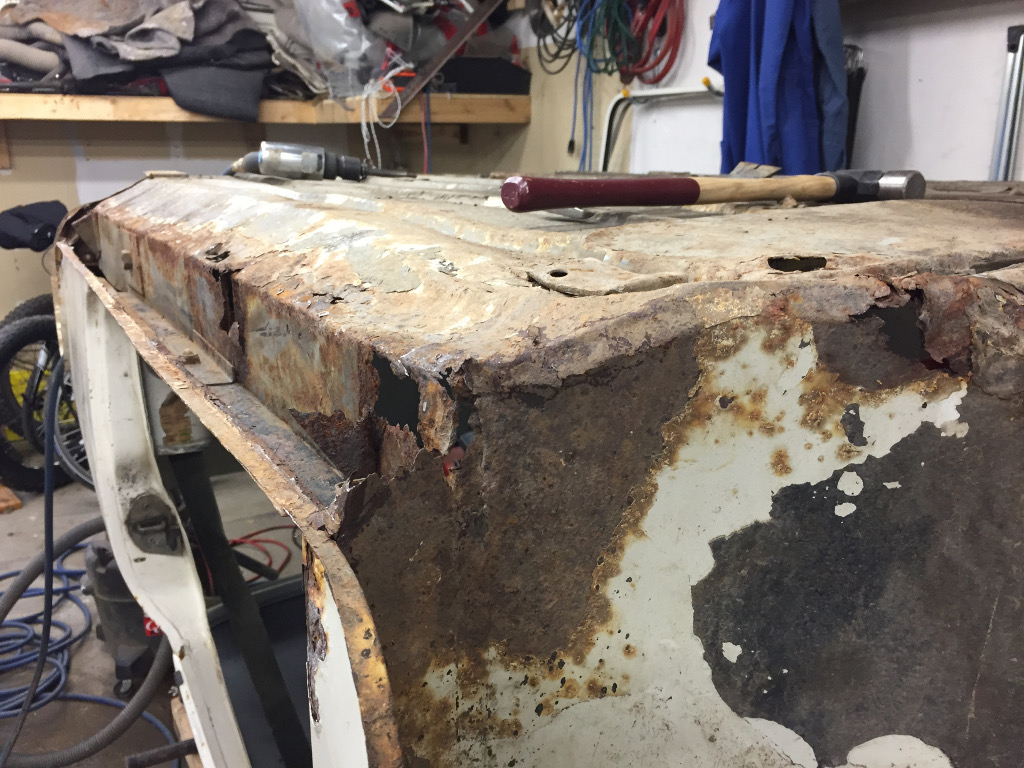

I've thought about getting the shell blasted, and I might still do it to clean up the rest of the shell that doesn't need to be replaced.  I did get a needle scaler to help assess/clean up.  I cut out the sill panels and rear valence to get a better idea of the shape of everything.
What remains of the lower 6" or so of the shell is mostly iron oxide.  The rear corners are always bad, but especially bad on a Canadian Mini with a bunch of extra holes for bumper trim and a bunch of extra reinforcing panels to trap all the salt used over the winter.  All that's left of the boot floor in the corners is the reinforcing panels.  The lower inch or so of the rear panel is mostly missing.  The boot floor, rear panel and rear valence are so rusted out that the lip that the rear bumper would attach to on most Minis is only barely attached to the rest of the body.  The front fenders and panel were in rough shape and the inner fenders were torn in two pieces.
Although most of the middle of the floor is fine, 6" on the sides and at the inner fenders is either full of holes or extremely banged up.  The rear subframe mount needs to be replaced, but it's really just the outer 6".  The left door is so mangled I'm not sure it's worth saving.  I thought the door step was in OK shape, but I was surprised by how thin the metal was where it meets the sill.
The front bulkhead is in surprisingly good shape.  No holes behind the shock mounts.  The battery box is also really solid.  :-)
So, yes, I'm going to get a lot of practice replacing panels.  I've been looking longingly at complete shells since BMH started making them for Minis.  I should have bought one back then, because they haven't gotten any cheaper.

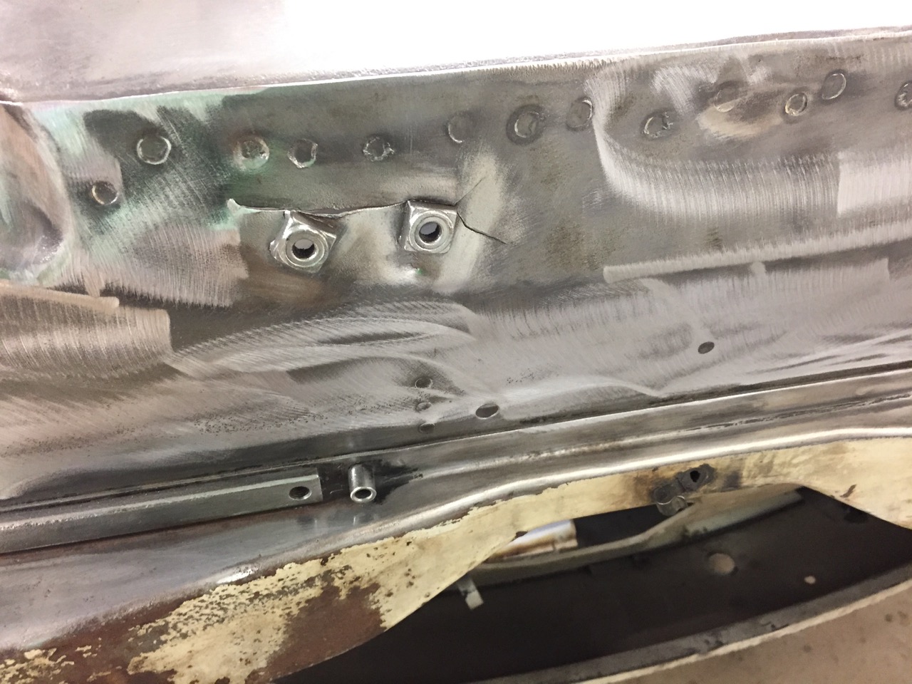

Some interesting cracking around the captive nuts for the accellerator
The rust doesn't look anywhere near as bad when you can't see the floor.  The rust is really only bad where the sand and salt was kicked up by the tires.
94touring
I've seen cracks there before.  Probably not unusual given the metal flexes every time the pedal is pushed.

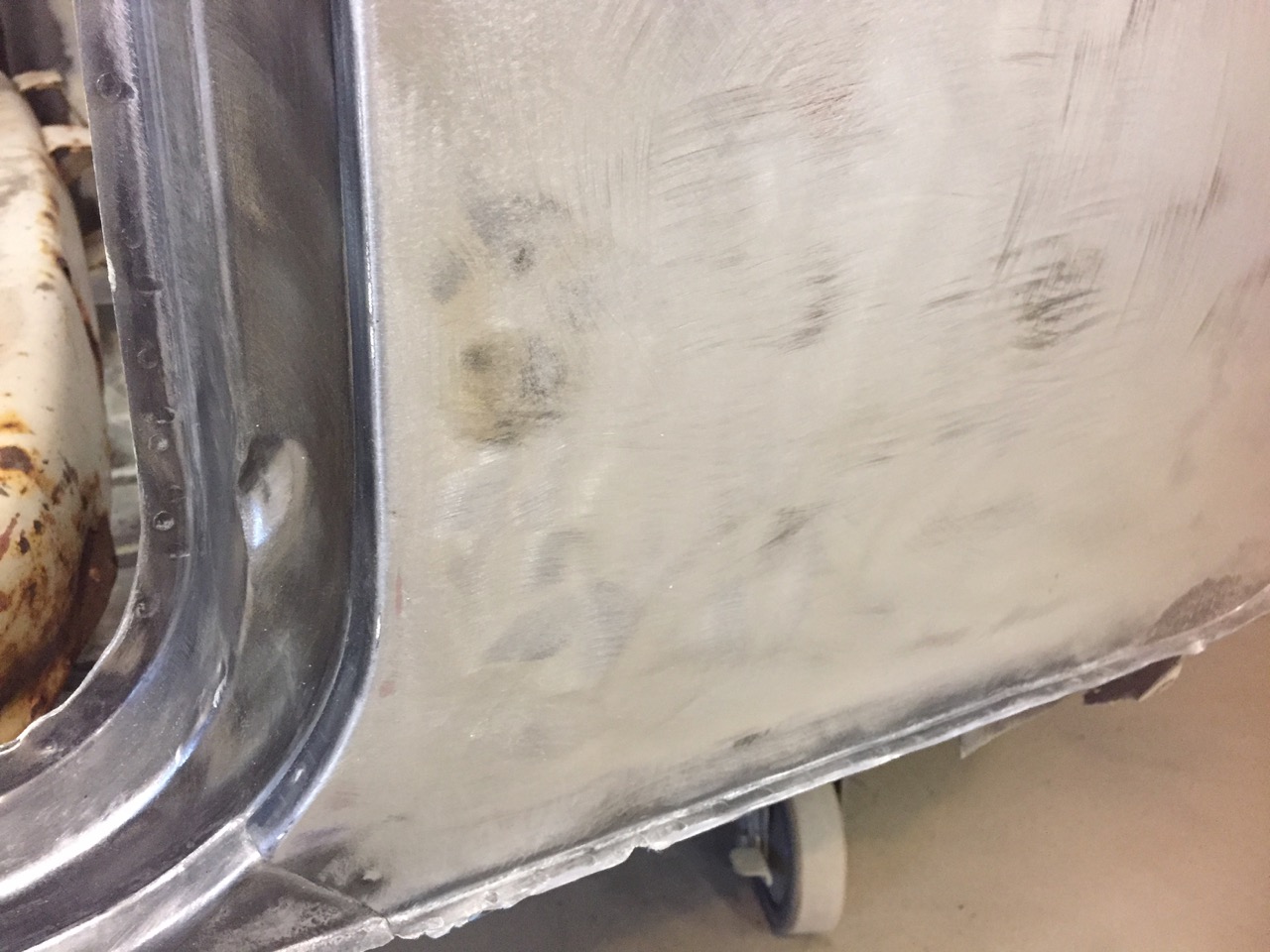

I stripped the left side and found a lot of body filler on the quarter panel.  I figured there was something up because the drivers door was from an older Mini (no side impact beam and no catch at the bottom of the door).
The B pillar/door frame had a few dents that were just filled:

Added bracing and started cutting out floor.  The seat pan was slightly bent, which I thought happened with a heavy backseat passenger and a speed bump, but turned out to be collision damage that meant the space between the rear wheel wells was about 3/4" too narrow for the new boot floor.  Which meant I took out more panels than I planned.  I'm not sure how many times I removed/replaced the rear subframe to make sure everything was still square/fitting.  Many.

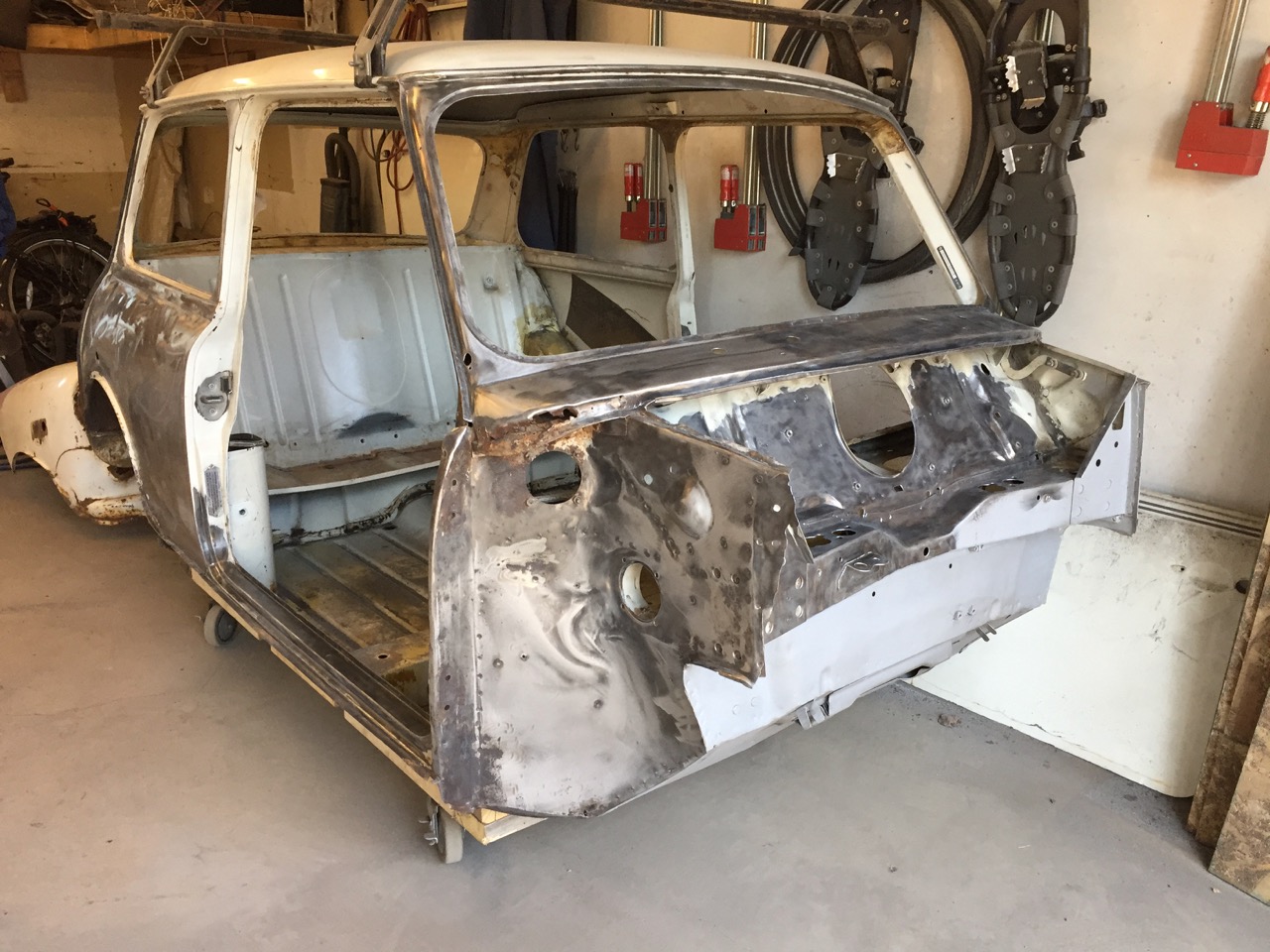

Some before and after pictures of the rear valence area.  As expected, everything is a lot more solid now.

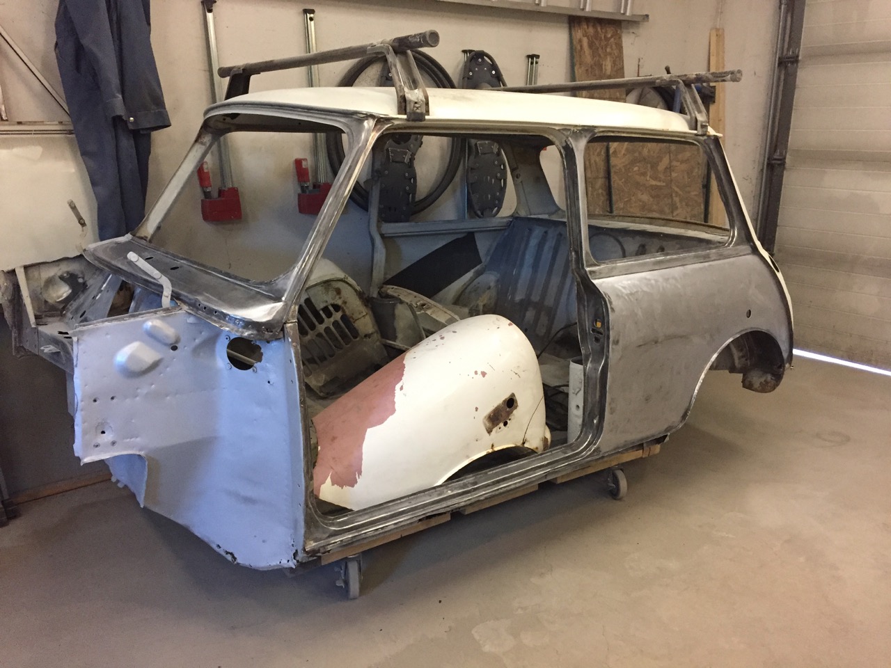

And then clecos and a bunch of plug and butt welds.
MiniDave
Good grief!  It looks like the only things you're keeping are the roof and the center tunnel?

Quote from: MiniDave on January 03, 2021, 07:08:52 PM
Well, the front bulkhead, seat back and parcel shelf are going to be original.  And I kind of regret not replacing the lower few inches of the seat back.  It's tissue-paper thin and frustrating to weld to the seat pan.
