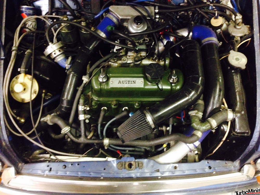

This was what the engine looked like for many years:
http://www.turbominis.co.uk/uploads/i/wh1632-oe1/turbodave-4206.jpg

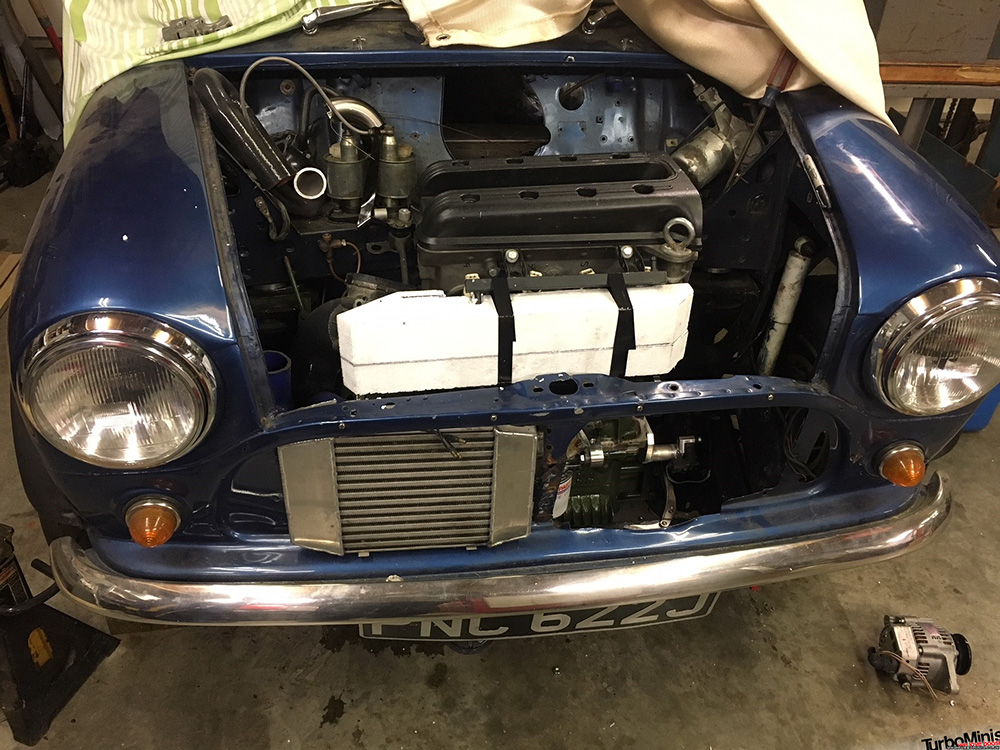

Also started playing with an intake plenum design, to accommodate the existing intercooler positioning, and that'd work with the drive-by-wire throttle body (no more cables, replaced with a bunch of wires LOL).
http://www.turbominis.co.uk/uploads/i/wh2016-oe1/turbodave-4209.jpg

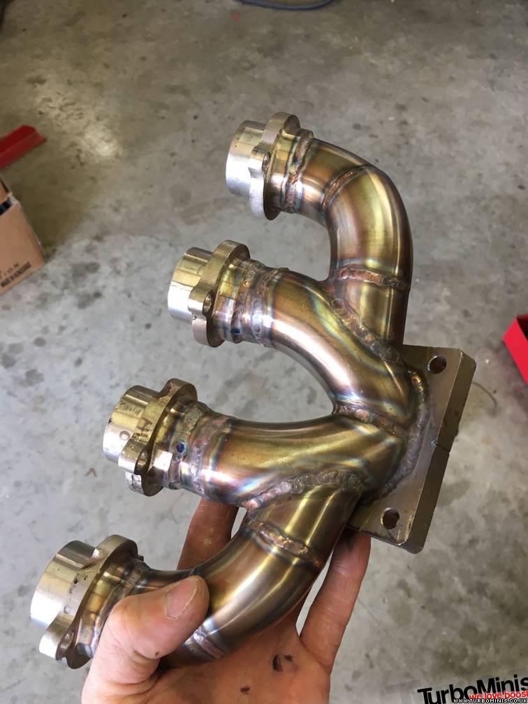

Then I knocked this little thing up over a couple of evenings (I did buy the flanges ready made mind):
http://www.turbominis.co.uk/uploads/i/wh756-oe1/turbodave-3790.JPG

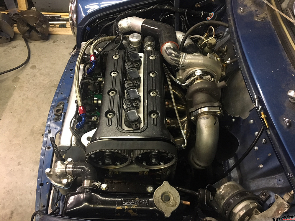

It started looking a little different:
http://www.turbominis.co.uk/uploads/i/wh2016-oe1/turbodave-4207.jpg
Almost ready for MME2017
http://www.turbominis.co.uk/uploads/i/wh2016-oe1/turbodave-4208.jpg
But an annoying issue with the timing belt walking would scupper that plan, leaving me making the trip in my F150!
Finally ready for the road:
http://www.turbominis.co.uk/uploads/i/wh1600-oe1/turbodave-4020.JPG

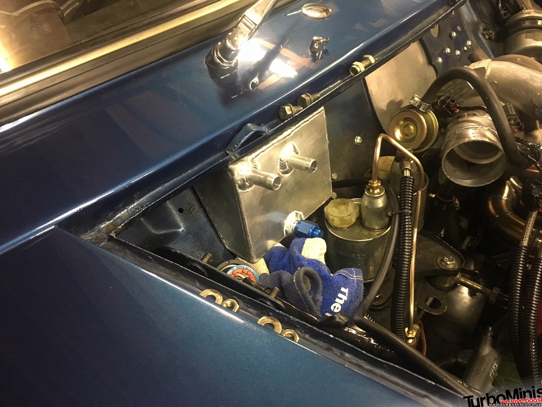

But first road test revealed way too much crank case pressure, and a catch tank needed fabricating.
Not much room, so made this unit. Can't tell, but there is a separator plate 1/4 the way down inside, to encourace the droplets to "separate" from the fumes.
http://www.turbominis.co.uk/uploads/i/wh1089-oe1/turbodave-4210.jpg

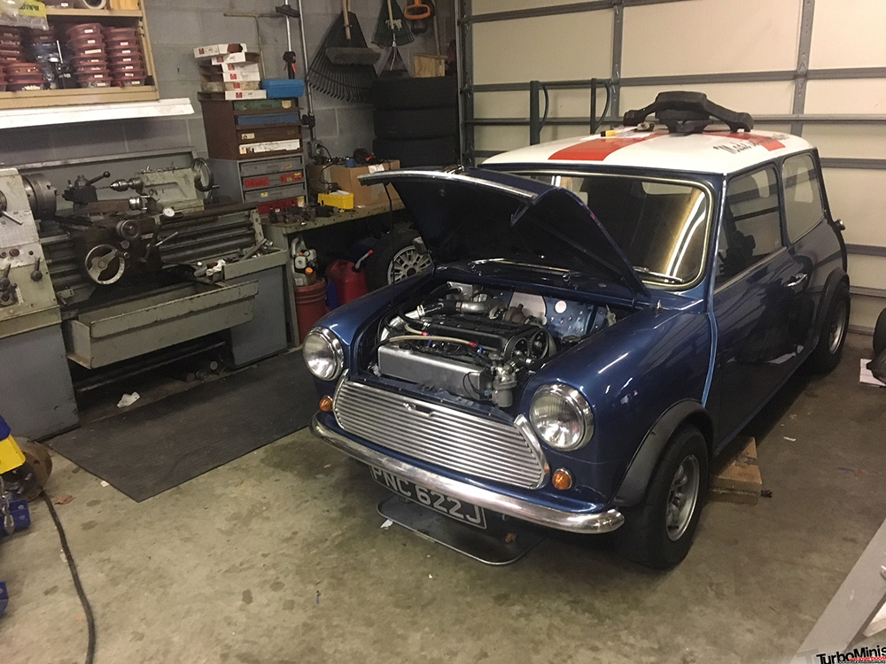

Pic as of a few days ago - engine about again to come out (!) for the new clutch I'm building up:
http://www.turbominis.co.uk/uploads/i/wh2016-oe1/turbodave-4205.jpg
