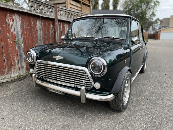

Hi all,
Long time no chat. It's been years of ups and downs but finally had an opportunity to get the Mini back on track. The car has gone through a labor of love but it's in a great spot now vs. before.
Tried to do DIY painting but that was a mess so gave up and sent it to a professional:
After that, upgraded the headlights to LED spec,
 :clap:
skmini
Looking shiny.  Classic Calgary skyline.
MiniDave
Paint turned out great! Glad to see you back, are you coming to Mini Meet East West in July? There are a number of western Canadians coming you could caravan with!
