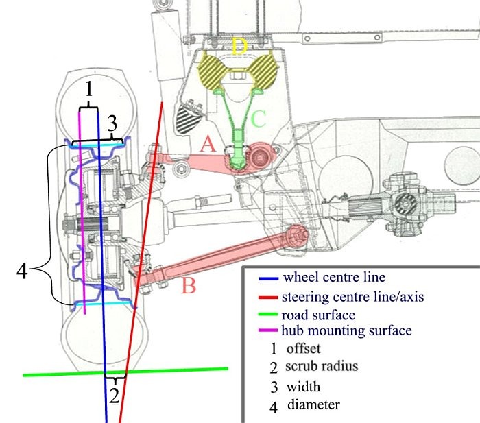

Gents I need a little help as I'm trying to go slow taking it easy w/o breaking anything.  My first time using the Sykes Pickavant tool for the cones.  Would someone please correct my thinking?   The way I understand it's use is as follows:
- The top 'handle threads the rod (Metric for >1976) into the female threads on top of the cone.
- The lower 'handle' then tightens the base sleeve causing the inner thread rod to pull the cone upward
I've now done this three times and each time I get to a point where I hear a loud 'POP' and the entire tool become loose from the cone.  Either my thinking is correct, I'm totally off base or perhaps the loud pop is the desired outcome.  I think what people are calling the 'trumpet' is below the cone.  Mine looks a little different than some 'hi-lows' I've seen.  I'm just slightly confused and I don't care to strip threads or break my tool.  I'm kind've proud of my first English tool...    Any insight?   I guess I'll go attempt to remove the lower arm from the sub-frame (this arm used to be attached to the hub).  Perhaps in doing so, something will present itself .. ???  Thanks in advance if anyone can offer advice.

Yes, your understanding of how it supposed to work is correct.  I would only add that the cone is compressed just enough to allow the trumpet to be removed.  Also, it's a good idea to lightly grease the point where the 'spinner' comes in contact with the top of tube.
Quote from: Lone Star Mini on September 18, 2017, 04:24:14 PM
There should be no pop at all.   The only time I've experienced a pop was when the captive nut broke out of the center of a very rusty cone on my old Mini from Canada. That was a complete mess to deal with.
As for your pop, it sounds like the threads of the rod are not engaging in the cone threads -- or if they are then the cone threads are mostly stripped out and then suddenly releasing under pressue.   Is it possible you (or somebody before you) used the SAE threaded rod vs. the correct metric one? (or vice versa depending upon the age of your cones)
If you continue to be unable to compress the cone, you may have to work below to sacrifice and destroy the trumpet in order to release the trumpet/cone.
BE CAREFUL please.  The front suspension is under a lot of tension (as you probably surmised by the loud pop of the tool).

You don't need to remove the cones to take the subframe out, I would remove the subframe and then disassemble it. The hardest part of removing the cones is to remove the upper control arm thru rods, but with the subframe out it's easy peasy. Of course, with the engine out it's a lot easier too.
I'm told it only takes 7 turns of the tool to compress the cone to it's maximum amount. Your goal is only to compress the spring far enough to get the trumpet or high low out.....but the cone won't come out of the subframe until the upper control arm is out too.
Take a pic of the trumpet for us? If you have adjustable trumpets (high lows) then you need to adjust it all the way down too.
Referring to Bruce's pic, that ball on the end of the trumpet will stick in the control arm too, and it can pop when it comes out. From a couple of the pics it looks like you have standard trumpets, not high lows, but a pic up close will let us know for sure.

You need to remove the upper control arm, then it will all come apart easily.......

The pops are when the threads give out. You probably have different threads than your tool.  Also like has been said, drop the subframe then remove.  Easier with it out and the upper arm's removed so they fall out.
Lone Star Mini
You guys are awesome!!  I greatly appreciate your help/input.  I'm thinking that perhaps I have used the wrong rod (not sure which is metric and standard).  Thought I was using the metric, but maybe I'm wrong.
As you said MiniDave, it appears that mine are the standard trumpets and what a tip. I will definitely drop the frame first as I thought I had to have everything removed (still have the steering rack in too).

What a GREAT cross section image.. thank you for that!!!
