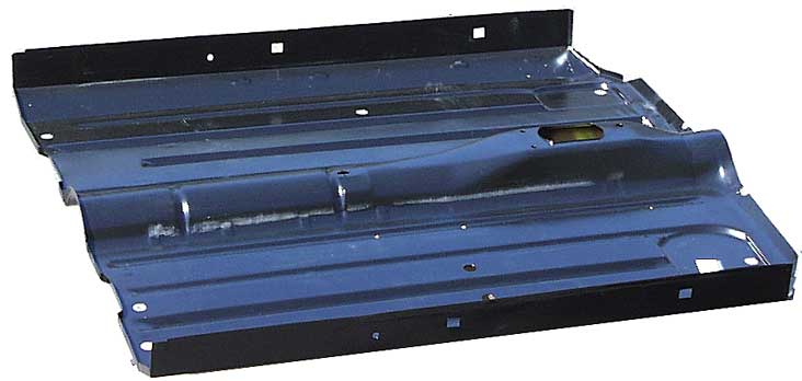

The floor boards are bad...really bad.  I'm thinking it needs new sheet metal underneath.  I'll see if i can take it to a lift somewhere and take pics of the underside for you.  I can tell you that the right side seat floor frame is broken because of the rust...which is not good.

Looking like you need some new floor pans, maybe whole sections and x-member may be questionable.  Cills, depending on how they really look under the undercoating are hopefully still good.  That stuff is a nightmare to get off too from a previous experience or two.

I have to ask...what is an X-member?  Is it where the seats bolt in?  While i was pulling the carpet up, i found myself pulling up some of the metal up with rust...I'm thinking it's pretty bad.

Hmm, basically how I get started is by pulling everything and anything off the car.  All interior, all exterior, and engine bay as needed or desired.  Then its a matter of fixing each bad area one by one and anything pulled off that needs attention one by one.  The interior I would typically leave the heater assembly and dash, unless something needs worked on.  In your case you're working on it.  So you could really take everything out and start going through the wires to get it sorted.  If its really bad and molested you could just replace the harness and start fresh since now would be the time to do that.
The x member is the part the seats attach to.  I could just tell by looking at the underside its probably rusted out pretty badly where it would spot weld to the floor.  Doesn't surprise me your carpet has become infused.  You really have the full restore on your hands since its floors, doors, and front end panels to replace.  Between panels, paint, materials and supplies you'll probably have close to 2 grand invested.  If I had to guess I'd say about 15-30 full days of work.  Thats my work time, lol, keep in mind I did a full bare shell tear down, replaced panels, and restore/reassembly (car at the top of the page) in 14 days over a xmas break.  For some reason I'm abnormally fast.  ;D  If you're bringing the car here for me to do all this, ideally it would be just a bare shell for me to work with.  At that point I could change colors easily, flip the car all around to work on floors, and also not have a huge pile of parts in the way.  I'll shoot you an email so we can get into more detail about this process.
